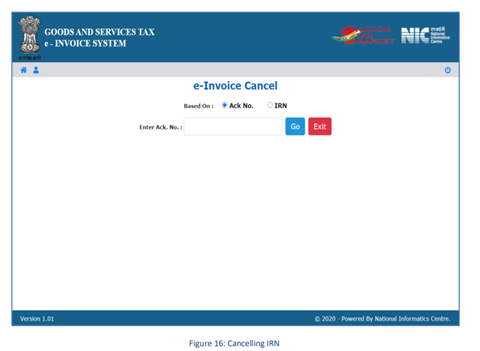

    To cancel the e-invoice, you need to login to e-invoice portal and follow the steps given below.
    Step-1: Login to https://einvoice1.gst.gov.in/
    Step-2: Select ‘e-Invoice’ from the main menu
    Step-3: Select ‘cancel’ option available in the e-invoice menu
    Step-4: Select and mention e-invoice ack.no or IRN
    Step-5: After mentioning, click ‘Go’
    Step-6: Next, the system will display the e-invoice that you want to cancel

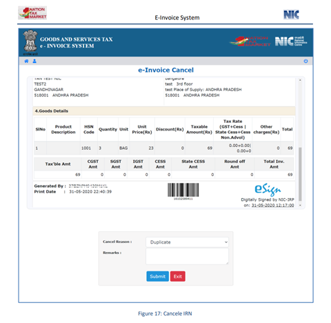

    Step-7: Select the cancellation reasons, mention the remarks and submit
    Step-8: After submitting, a success message along with the cancelled e-invoice with a “Cancelled” watermark is displayed.

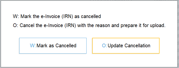

    To cancel an e-invoice in TallyPrime, you just need to select the invoice for which IRN is already generated and select ‘update cancellation’ along with a reason. The system will automatically prepare it for cancellation by directly interacting with the IRP portal.
