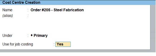

    • You simply go to your F11 features and Set 'Enable Cost Centres' to Yes > Set 'Enable Job Costing' to Yes.".
    • Then, you create a name for your project using the 'Cost Centre' feature.
    • For example, you can create a tag called "Order #205 - Steel Fabrication". That’s it, the setup is done.

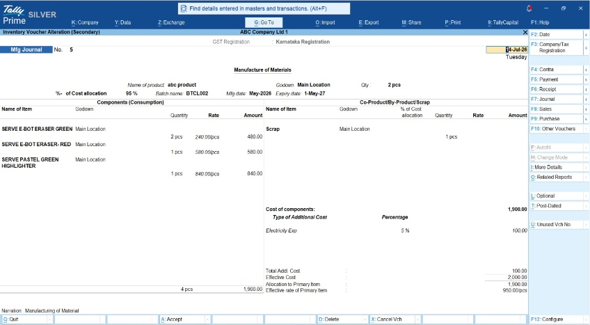

    2. The daily store routine (material vouchers)
    • When raw materials (like steel sheets or welding rods) are sent to the factory floor, the storekeeper simply passes a Material Out voucher.
    • They just pick the item, enter the quantity, and select "Order #205" from a simple dropdown menu. It is as easy as making a basic sales invoice.
    • When the finished goods are ready, they record a Material In voucher.
    3. The background magic (zero manual calculations)
    Your staff just enters the raw data, but TallyPrime does the heavy lifting in the background. It automatically:
    • Deducts the consumed raw materials from your main godown inventory.
    • Allocates the exact financial cost of those materials to that specific job.
    • Tracks any additional expenses, like daily labor wages or electricity, tagged to that Cost Centre.
    By the time the manufacturing process is complete, you don’t have to sit with a calculator. You just open the Job Work Analysis Report, and the software presents a ready-made, highly accurate profitability statement showing exactly how much you spent and how much profit you made on that single order.
