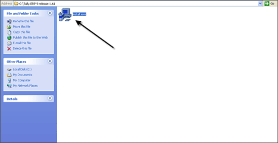

Step 1: Double click on the Install.exe to execute the installer.

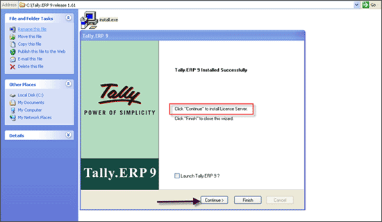

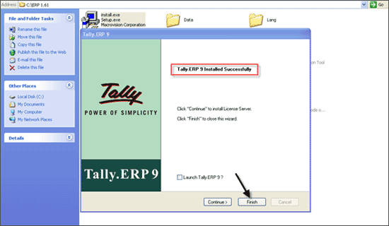

Step 5: You will get the message "Tally.ERP 9 Installed Successfully". Click the button "Continue" to install "license Server".
Note: License Server is used for ensuring that workstations connected in the network are able to work on Tally.ERP 9.

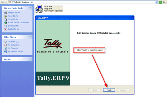

Step 6: For installing License server ensure that "License Server" radio button is selected and click the button "Next" and Install.
You will get the message, Tally License server 4.0 Installed successfully. You can click on Finish to close the Wizard.

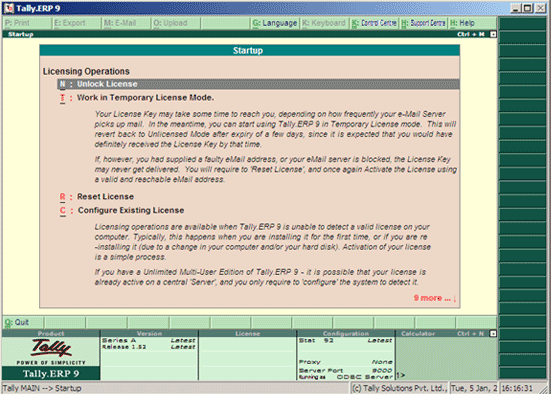

Step 1: Start Tally.ERP 9 -> Click on Activate License.
Step 2: Click on Activation of Promotional rental license.
a) Click on activation in single user mode if you are deploying this on a desktop.
b) if you want to deploy a multi-user, please select  "Option (1) Install and Start License Server in this system".
Step 3: Enter the promotional code provided to you as in the screen below (Eg: BPP.sudheendra@tallysolutions.com) and then enter your email ID and press ENTER.
Step 4: You will get the below screen and then press ENTER.
Step 5: Click on Unlock license.

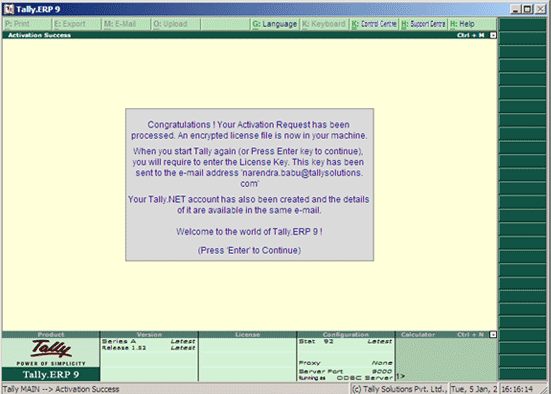

Step 6: Check your mailbox you will receive the Unlock key.
Type or copy and paste (Ctrl+Alt+V) the Unlock Key and then press ENTER, and get started with Tally.ERP 9.
Press Enter button and you will get the message "Congratulation, Tally.ERP 9 Activated Successfully".
